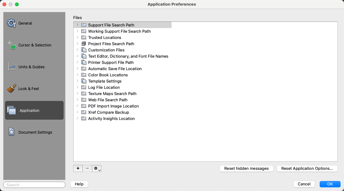

Application Tab (Application Preferences Dialog Box)
Lists the folders in which the program searches for support, driver, menu, and other files. Also lists optional, user-defined settings such as which dictionary to use for checking spelling.

The following options are displayed.
Support File Search Path
Specifies the folders in which the program should look for text fonts, customization files, plug-ins, drawings to insert, linetypes, and hatch patterns that are not in the current folder.
Working Support File Search Path
Displays the active directories that the program searches for support files specific to your system. The list is read-only and displays valid paths from the Support Files Search Path that exist within the current directory structure and network mappings.

Add
Adds a search path for the selected folder.
Remove
Removes the selected search path or file.
Options
Edits or changes the order of a selected path.
Change Path
Displays the Browse for Folder or Select a File dialog box, depending on what you selected in the Files list.
Move Item Up
Moves the selected search path above the preceding search path.
Move Item Down
Moves the selected search path below the following search path.
Set as Current
Makes the selected project or spelling dictionary current.
Reset Hidden Messages
Resets the display of all message boxes that you marked to not display again or to always use a specified option in them.
Reset Application Options
Displays the Reset Application Options dialog box. Click Restart AutoCAD to restore the program defaults.
