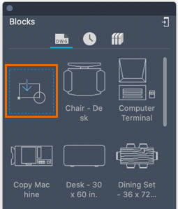

Displays the blocks in the current drawing.

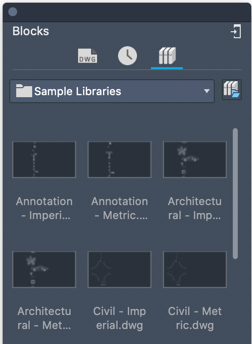

Displays the blocks from a block library. Click browse to specify a drawing file or folder.
Block Libraries Navigation
- Specify a cloud storage file or folder that contains the blocks. Use this method to share blocks across devices. A block library located on the cloud is indicated on the palette.
- Double-click a subfolder to display the contents of that folder.
- Click Back to Library to return to the previous drawing or folder.
- Select Sample Libraries from the drop-down menu to access the legacy block libraries.

Displays the blocks for the selected category. To insert a block do one of the following:
- Drag and drop a block from the list
- Double-click on a block thumbnail
- Right-click on a block thumbnail and select Insert in Drawing
- Click the block icon from the current drawing view to browse to any DWG file to insert
