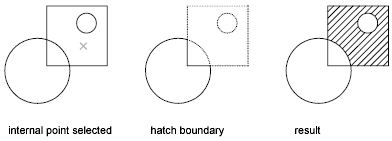

- Specify a point in an area that is enclosed by objects.

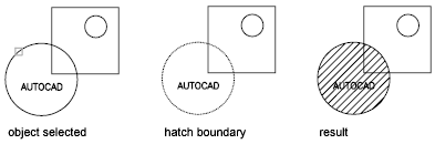

- Select objects that enclose an area.

- Pick internal point
- Determines a boundary from existing objects that form an enclosed area around the specified point.
- Select objects
- Determines a boundary from selected objects that form an enclosed area.
