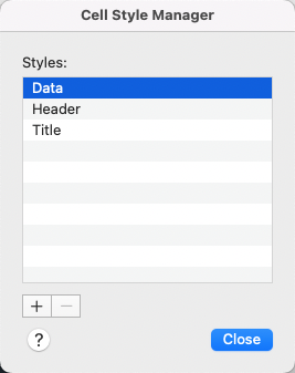

Displays all cell styles within the current table style and allows you to create or delete a cell style.
Access Methods
TABLESTYLE (Command)
Tool Sets:
Menu: .
On the Table Style Manager dialog box, select New
or Modify.
, then click Manage Cell Styles.
List of Options
The following options are displayed.
- Styles
Lists all cell styles contained within the current table style. The cell styles Title, Header, and Data are always contained within any table style.
- New
Displays the Create New Cell Style dialog box. From here, you can create a new cell style to be contained within the current table style.
- Delete
Allows you to delete the selected cell style.
- Rename
Right click a cell style name to give a new name to the selected cell style. The Title, Header, and Data cell styles cannot be renamed.
