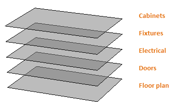

You gain this level of control by organizing the objects in your drawing on layers that are associated with a specific function or a purpose. It might be helpful to think of layers as clear plastic sheets:
With layers, you can
- Associate objects by their function or location
- Display or hide all related objects in a single operation
- Enforce linetype, color, and other property standards for each layer

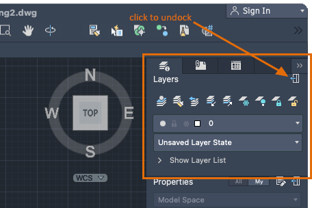

To see how a drawing is organized, use the Layers palette. By default, the Layers palette is docked on the right side above the Properties Inspector. Undock the palette to resize the palette and individual columns within the palette.

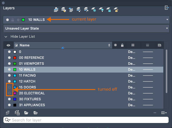

Here's what the Layers palette displays in this drawing.
As indicated, layer 10 WALLS is the current layer. All new objects are automatically placed on that layer.
In the visibility column, notice that the circle icons for two layers are not filled in. These layers were turned off to hide the doors and electrical wiring in the floor plan.
Notice that each layer name starts with a two-digit number. This convention makes it easy to control the order of the layers because their order does not depend on the alphabet.

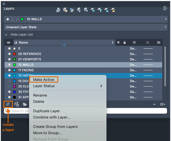

Controls in the Layer Properties Manager
To create a layer, click the button shown and enter the name of the new layer. To change the current layer, double-click the layer name or right-click the layer name and select Make Active.

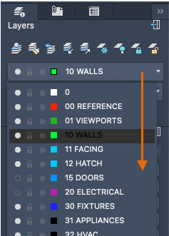

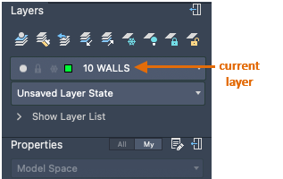

The Layers palette takes up a lot of space, and you don't always need to access all the options. For quick access to the most common layer controls, dock the Layers palette. When no objects are selected, the palette displays the name of the current layer as shown here.
Occasionally, check to make sure that the objects you create will be on the correct layer. It's easy to forget to do this, but it's also easy to set. Click the drop-down arrow to display a list of layers, and then click a layer on the list to make it the current layer. You can also click on any icon in the list to change its setting.
