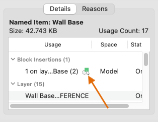

  3. Click Non-Purgeable Items.
  4. In the left pane, expand the tree view for Blocks.
  5. Select a block definition in the tree view that you want to preview and locate in the current drawing.
  6. Under Details in the right pane, click Select Objects.
    The dialog box closes, the specified block references are all selected, and the drawing automatically zooms to include them all.
