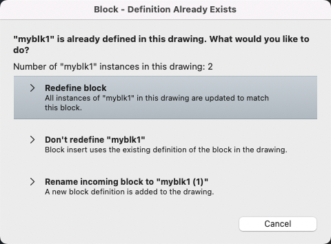

The dialog box displays.
- Click Redefine Block.
- Insert an instance of the block. All instances of the block on the current drawing update.

- In the dialog box, click Redefine Block.
