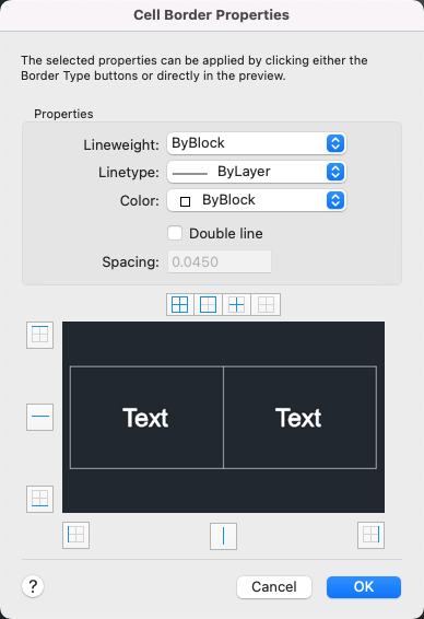

- On the Properties Inspector, click Border Style.
The Cell Border Properties dialog box displays.
- In the Cell Border Properties dialog box, select a lineweight, linetype and color. To specify a double line border, select Double Line.
Use BYBLOCK to set the border properties to match the settings in the table style.
- Click one of the border type buttons to specify which borders of the cell to modify.
- Click OK.
