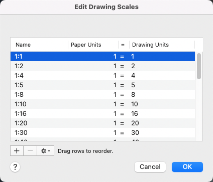

Edit Drawing Scales Dialog Box
Controls the list of scales available for layout viewports, page layouts, and plotting.
SCALELISTEDIT (Command)
Menu: Format > Scale List.
List of Options
The following options are displayed.
Scale List
Displays the list of currently defined scales. Also displays temporary scales that are imported when xrefs are attached. If a scale name is duplicated, but has a different value, a number is appended to the name.
Add
Creates a new scale in the scale list.
Press Tab to move between the fields of the scale being edited.
Delete
Removes the selected scale from the scale list.
Note: You cannot delete a scale that is referenced by an annotative object.
Options
Manages items in the scale list.
Edit
Edits the selected scale in-place in the scale list.
Note: You cannot edit temporary scales.
Reset
Deletes all custom scales and unused scales and restores the default list of scales.
