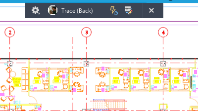

Markup Import and Markup Assist were introduced in AutoCAD for Mac 2024 and help provide a way to view and insert drawing revisions with less manual effort.
Markup Assist now can detect and identify markups in flattened PDFs.
The Markup Assist icon on the Trace toolbar indicates when Markup Assist is in the process of detecting markups.
