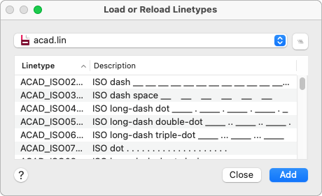

- File Name
Displays the name of the current LIN file. You can enter the name of another LIN file or click the File button to select a file from the Select Linetype File dialog box.
- Browse
Displays the Select Linetype File dialog box, in which you can select a different linetype (LIN) file.
- Available Linetypes
Displays the linetypes available to load. To select or clear all of the linetypes on the list, right-click and choose Select All or Clear All.
