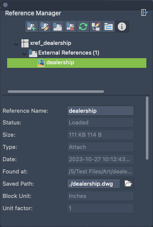

The Reference Manager palette organizes, displays, and manages referenced files. The referenced files that can be managed from the Reference Manager palette are:

The Reference Manager palette contains a toolbar along the top. You can right-click over the files list to display a shortcut menu that allows you to attach or manage an attached external reference. Click the Show Details button on the toolbar to view details and thumbnail preview for the selected external reference.

Show Details
Displays the Details and Preview panel which displays a thumbnail preview and details for the selected file reference.
