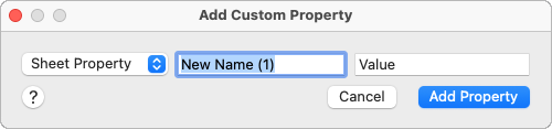

Add Custom Property Dialog Box
Creates a custom property to be associated with the current sheet set or with each sheet.
SHEETSET (Command)
Menu: Window > Sheet Set Manager: Select a sheet set or sheet > click Add Property in Details panel.
Note: If the Details panel is not visible, click .
List of Options
The following options are displayed.
Owner
Specifies whether the custom property will belong to the sheet set or sheet.
Name
Specifies the name of the new custom property.
Default Value
Specifies a value for the custom property.
