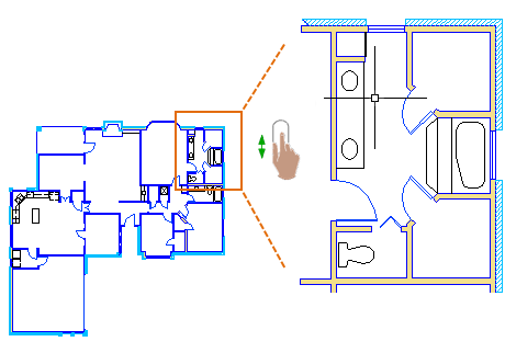

Pan and zoom to different views in a drawing.

Pan the drawing view
Zoom in or out.
