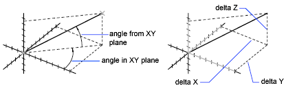

In general, the DIST command reports 3D distances in model space and 2D distances on a layout in paper space.
In model space, changes in X, Y, and Z component distances and angles are measured in 3D relative to the current UCS.
In paper space, distances are normally reported in 2D paper space units. However, when using object snaps on model space objects that are displayed in a single viewport, distances are reported as 2D model space distances projected onto a plane parallel to your screen.
