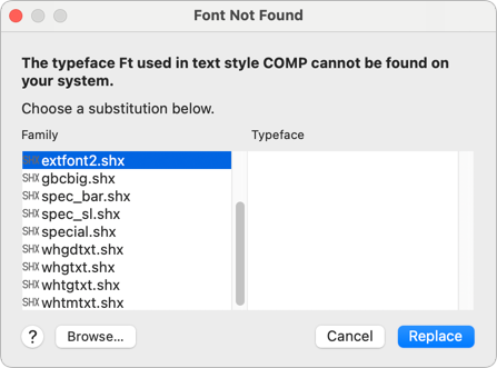

Font Not Found Dialog Box
When you open a drawing with a missing font file, this dialog box is displayed to allow you to choose a replacement font file for the style.
List of Options
The following options are displayed.
Family
Lists the font family name for all SHX fonts in the Fonts folder or all registered TrueType fonts.
Typeface
Lists all available Asian-language typeface files when a typeface is missing.
Note: Available only when a style is using a SHX font file.
Browse
Displays the Open dialog box (a standard file selection dialog box), in which you can select a different font file to use.
