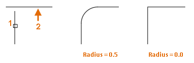

The fillet radius determines the size of the arc created by the FILLET command, which connects two selected objects or the segments in a 2D polyline. Until you change it, the fillet radius applies to all subsequently created fillets.
Note: If the fillet radius is set to 0, the selected objects are trimmed or extended until they intersect; no arc is created. When the fillet radius is set to 0, you can remove the arc segment between two straight line segments or all arc segments from a 2D polyline.

Tip: Press and hold Shift while selecting objects or line segments to override the current fillet radius with a value of 0.

- In the drawing area, select the first object or line segment that will define the points of tangency for the resulting arc.
- Select the second object or line segment.
