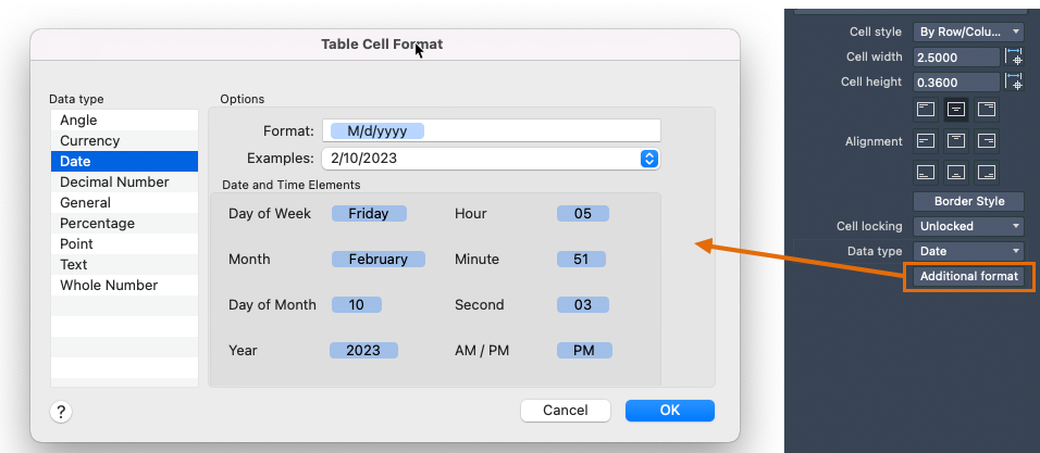

- If the Properties Inspector isn't open, click .
- On the Properties Inspector, select a data type from the drop-down menu.
Different formatting options are shown depending on the data format selected.
- Define the format.
- If available, click Additional Format to display the Table Cell Format dialog box with more formatting options.
- Select from the available options.
- Click OK.
