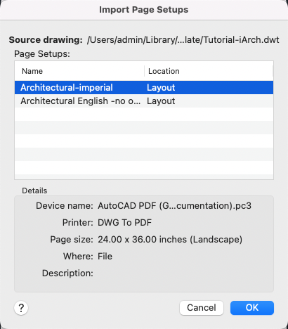

Import Page Setups Dialog Box
Displays the page setups in the selected drawing that are available to import.
PAGESETUP (Command)
Toolbar: : > Import
List of Options
The following options are displayed.
Source Drawing
Displays the source drawing that contains the listed page setups that are available to import.
Page Setups
Lists the page setups that are available to import and their location in the source drawing. Selected page setups are imported into the current drawing when you click OK.
When you import page setups into a page setup overrides file for a sheet set, only page setups with Plot Area set to Layout or Extents are listed.
Name
Specifies the name of the page setup available to import.
Location
Specifies the location (Model or named layout) of the page setup in the drawing from which you are importing the page setup.
Details
Displays information about the selected page setup.
Device Name
Displays the name of the plot device specified in the currently selected page setup.
Printer
Displays the type of output device specified in the currently selected page setup.
Page Size
Displays the paper size and orientation specified in the currently selected page setup.
Where
Displays the physical location of the output device specified in the currently selected page setup.
Description
Displays descriptive text about the output device specified in the currently selected page setup.
