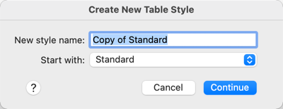

Specifies a name for the new table style and specifies the existing table style on which the new table style will be based.
Access Methods
Command entry: TABLESTYLE (Command)Tool Sets:
On the Table Style Manager dialog box, click New.
List of Options
The following options are displayed.
- New Style Name
Names the new table style.
- Start With
Specifies an existing table style whose settings are the default for the new table style.
- Continue
Displays the New Table Style dialog box, in which you define the new table style.
