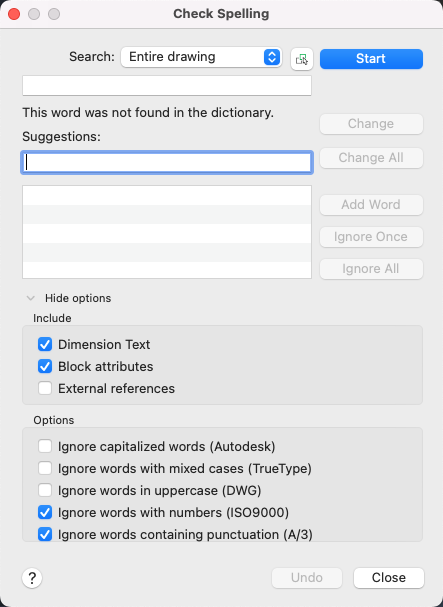

Provides options to change the way the default behavior of the spelling checker in the In-place Text editor.
SPELL (Command)
Tool Sets:
Summary
Specifies specific text options that will be checked in your drawing.
List of Options
The following options are displayed.
Include
- Dimension Text
Searches dimension text.
- Block Attributes
Searches block attributes text for spelling errors.
- External References
Specifies to search external references for spelling errors.
Options
- Ignore Capitalized Words
Specifies to ignore capitalized words.
- Ignore Words with Mixed Cases
Specifies to ignore words that contain uppercase and lowercase letters.
- Ignore Words in Uppercase
Specifies to ignore words that are in all uppercase.
- Ignore Words with Numbers
Specifies to ignore words that include numbers.
- Ignore Words Containing Punctuation
Specifies to ignore words that contain punctuation.
