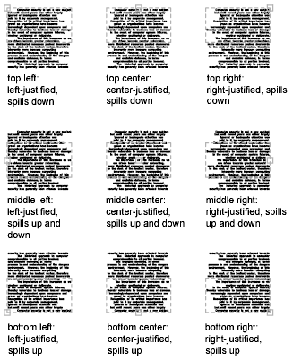

Justify
Determines both text justification and text flow, for new or selected text, in relation to the text boundary. The current justification is applied to new text. The text is justified within the specified rectangle based on the justification setting and one of nine justification points on the rectangle. The justification point is based on the first point used to specify the rectangle. Text is center-, left-, or right-justified with respect to the left and right text boundaries. Spaces entered at the end of a line are included as part of the text and affect the justification of the line. Text flow controls whether text is aligned from the middle, the top, or the bottom of the paragraph with respect to the top and bottom text boundaries.
Enter justification [TL/TC/TR/ML/MC/MR/BL/BC/BR] <TL>.
Justify Options |
Option |
Meaning |
TL |
Top Left |
TC |
Top Center |
TR |
Top Right |
ML |
Middle Left |
MC |
Middle Center |
MR |
Middle Right |
BL |
Bottom Left |
BC |
Bottom Center |
BR |
Bottom Right |
The following illustrations show each justification option.
