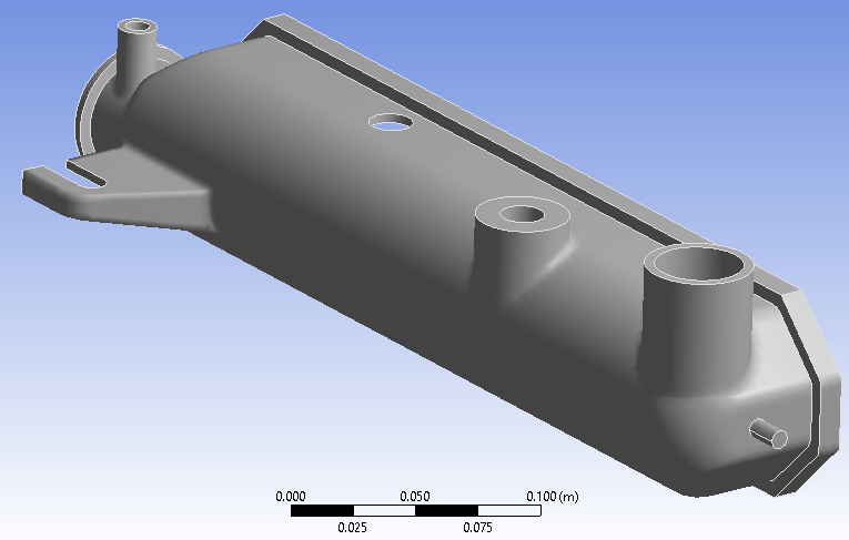

A model of the radiator tank has been created for ANSYS Workbench and ANSYS Mechanical. To begin working with the model:
  1. Open the Workbench project file radiatortank.wbpj.
    Note: Ignore the warning about the missing files
  2. Right click Model in the Static-Structural analysis system and choose Edit. This will open the model in ANSYS Mechanical.
open model
At this stage, only the tank geometry and the mesh have been created.
