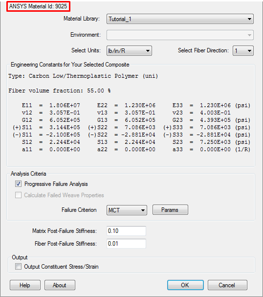

  1. Open Tutorial 1 and create the user material (which is named Tutorial_1) using the instructions provided in Tutorial 1 (Characterize a User Material with Composite Material Manager).
  2. Determine the ANSYS Material ID (matID) number for Tutorial_1 by opening the Helius PFA plug-in from within ANSYS and selecting Tutorial_1 from the Material Library list. The location of the Material ID number is highlighted below. Alternatively, the matID can be determined by opening the HPFAMatDB.xml file, which is located in the Helius PFA Material directory. The particular value of the Material ID may differ depending on the number of materials in your Helius PFA Material directory.
    create gui
  3. Locate the section containing the MP commands within Tutorial_2_ANSYS.ans.
  4. Replace the set of MP commands with the following, ensuring that matID is replaced with the value determined in step 1:
    HELIUSPFA, matID, 7,3,1,1,0,0,0,0,0,0,0,0,0.1,0.01,0
