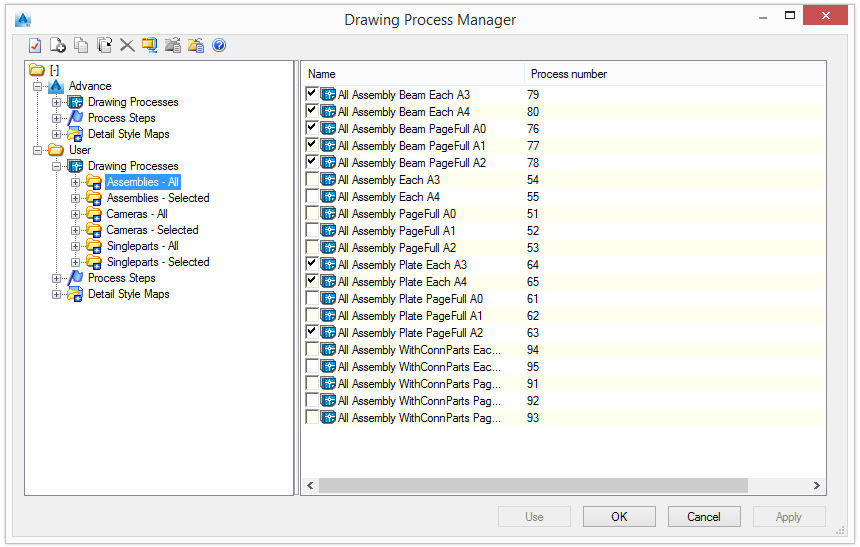

The main dialog box of the Drawing Process Manager displays the prototypes from the Standard, Country AddIn and User categories in a tree structure.
For a selected category, the content is displayed on the right side of the dialog box and on the tree panel.

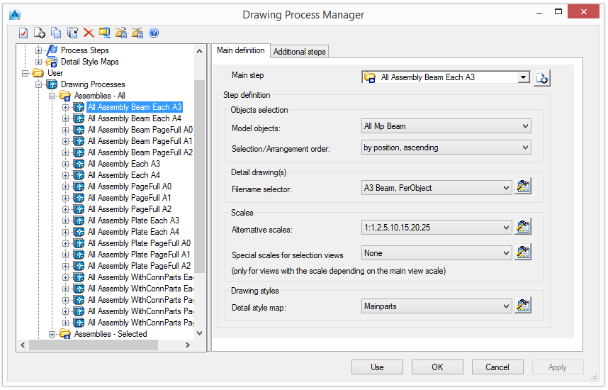

If a process is selected, the definition of the process is displayed. Modifications can only be made to processes in the User category.
The process steps category enables quick access to the definition and configuration of steps. If a process step is selected in the Drawing Process Manager tree, the step definition is displayed on the right side of the window.

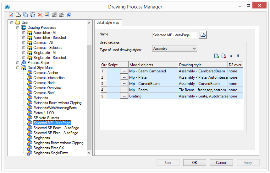

Assigning an appropriate drawing style to the process to the elements of the 3D model is done using the Detail style map option. This determines the presentation of the model elements on the drawing.
The Detail style map category groups all the detail maps for quick access to the definition and configuration. If a style map is selected in the Drawing Process Manager tree, the definition is displayed on the right side of the window.
