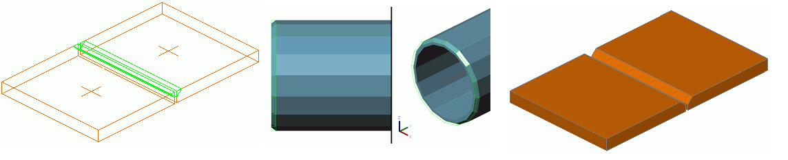

Using this tool you can create chamfered and filleted weld preparations on the edges of the selected element.
Weld preparations can be created on the straight edges of plates, on straight beams (whether they already have a shortening), which includes round and rectangular sections. The weld preparation length is based on the exact section, which means that it takes into consideration the beam corners.
Variable lengths (offsets) can be specified in the properties dialog box.
The Exact with weld preparation representation type shows the resulting exact shape with bevels at the edges. Weld preparations are represented in green.
