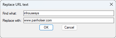

REPURLS (Express Tool)
Finds and replaces a specified text string in a URL used in hyperlinks that are attached to all selected objects.
Find
You can specify a full specified URL or a partial URL. For example, you can replace all .com hyperlink references with .net, or you can replace an in-house URL with one for an external website in a single operation.
Files
avip_url.lsp, avip_url.dcl
