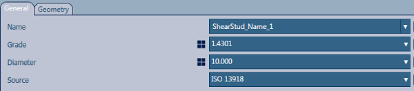

Example: Define a new shear stud with new properties
  1. In the General tab, click the New button next to the Name field drop-down list. Enter the name of your new shear stud and click Apply.
  2. Choose a grade from the drop down list or create a new grade, by clicking the New button next to the Grade field drop-down list, type a new name and click Apply.
  3. From the Diameter drop-down list, choose a value.
    Note: You can also create a new diameter value, using the New button next to the Diameter field drop-down list, if you cannot find a suitable one in the existing list.
  4. Create a new source (norm) by clicking the New button next to the Source field drop-down list, type a new name and a description and click Apply.

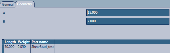

  5. Move to the Geometry tab and define the geometry of the new shear stud:
  6. At this point, you can save your new shear stud in the database. Click Apply to do so.

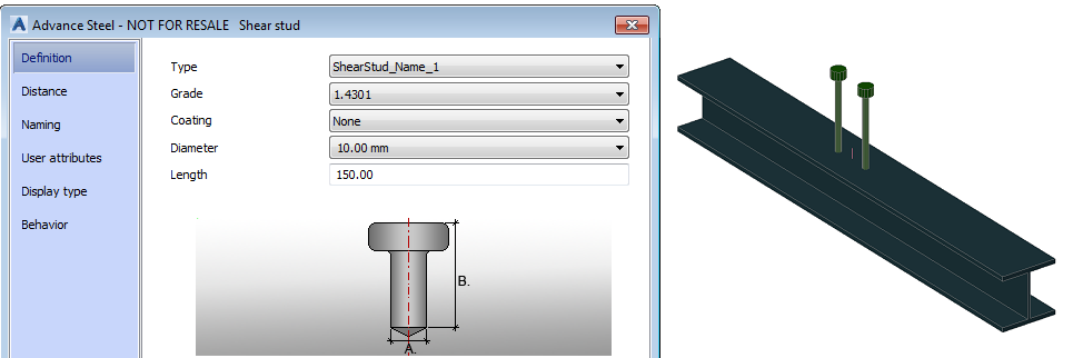

Tip: If Advance Steel was open during the customization process, click the (Update defaults) button in the Tools tab Tools panel to refresh the database to include your new settings.
You can now use your new shear stud in the 3D model as needed:
