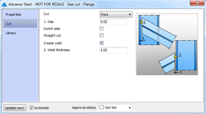

Saw cut Properties - Cut tab
Saw cut - Flange
Cut
Select the side of the main beam Front - on the front side of the main beam Rear - on the back side of the main beam
Gap
Defines the construction gab between the beams.
Switch side
Straight cut
Cuts the beam vertically. Otherwise, the second beam is cut parallel to the first beam.
Create weld
Creates a weld between the two beams.
2. Weld thickness
Defines the weld thickness.

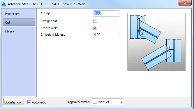

Saw cut - Web
On this tab of the properties dialog box, you can set the clearance between the beams.
Gap
Bisecting line
When selected, the intersection of the beams is created at the bisecting line.
Create weld
2. Weld thickness
