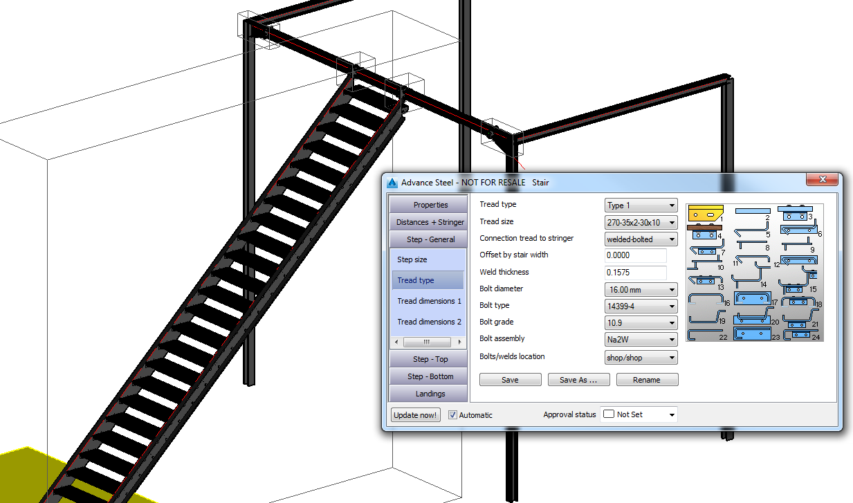

You can find the buttons for creating such structures in the Extended Modeling tab Structural Elements panel.
Example: Create a straight stair between two points
  1. In the Extended Modeling tab Structural Elements panel, click (Straight stair).
  2. Choose a method to define the stair size (Start and end point, Length and angle, or Height and angle).
  3. Select the points and enter the values based on the selected method to create the stair.
  • The stair is created and can be modified in the dialog.
