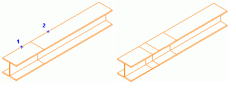

Split Beams
You can split beams into two or more beams by specifying the split points. Processings of the original beam are transferred onto the newly created beams.
This tool can be used on straight and curved beams.
Tip: To split the selected beams in equal segments, place snap points at equal user defined intervals. See Dividing beams tool.
Access the command
On the Objects tab Beams panel, click (Split beams).
Command line: _AstM4CommSeparateBeams
Split a beam
  1. On the Objects tab Beams panel, click (Split beams).
  2. Select a beam and press <Enter>.
  3. Select a split point and press <Enter>.
  • The selected beam is split.
Split several beams
  2. Select the beams and press <Enter>.
  3. Select the split point(s) and press <Enter>.
  • The beams are split.
