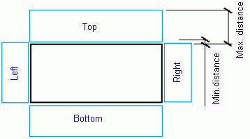

Set the search angle and the minimum and maximum distance for each iteration step.
| Search angle | This option defines the search direction (angle) for a free position. This option is dependent on the system settings in AutoCAD (Menu format - Units - Direction). By default, 0° is in the East and it is measured anticlockwise. |
| Min. distance | This option defines the smallest allowed distance from the object. |
| Max. distance | This option defines the largest allowed distance from the object. |
