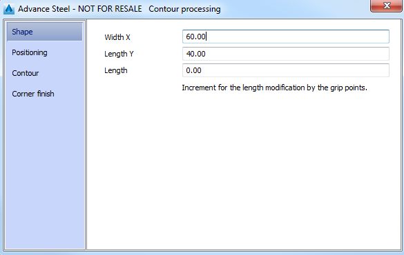

Contour Processing Dialog: Shape Tab
Use the parameters on this tab to modify the rectangular contour size.
Width X Defines the width of the rectangular processing.
Length Y Defines the length of the rectangular processing.
Length Defines the length increment (grid jump) when modifying the contour length using the grips.
