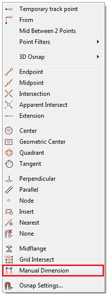

Alternatively, you can activate this snap by accessing the quick Snap dialog during point selection, using Shift + Right click:

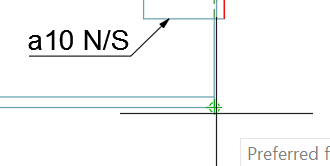

Graphically, the snap is represented by a circle and a cross when hovering your mouse cursor over a valid Advance Steel dimension point, with the snap active:

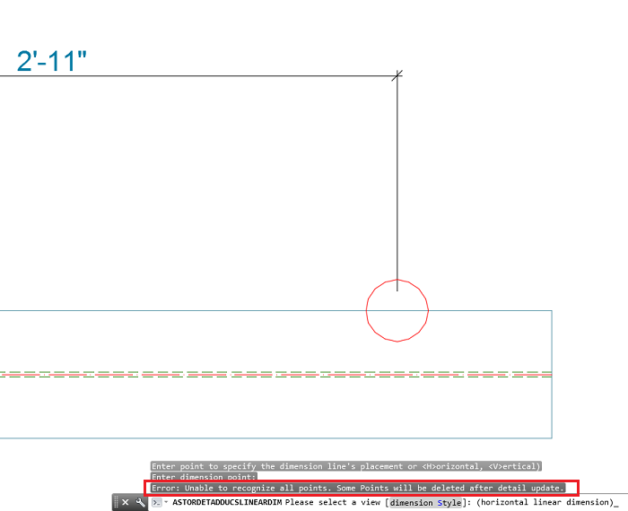

Important: Take note that if you pick an invalid dimension point to define a dimension line, that invalid dimension point will be highlighted with a red circle in the detail drawing, along with a message in the command line warning you that any invalid point will be deleted after update. If you want to create a dimension defined by only two points and at least one of the points is invalid, the entire dimension will be deleted after update. Make sure that all the points you pick to define the dimension line are valid.
