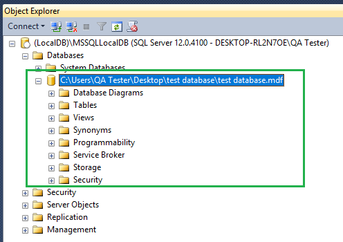

  5. Browse for the location of the database you want to open, select the database MDF file and click OK.
  6. The selected database will appear in the Object Explorer, under Databases.

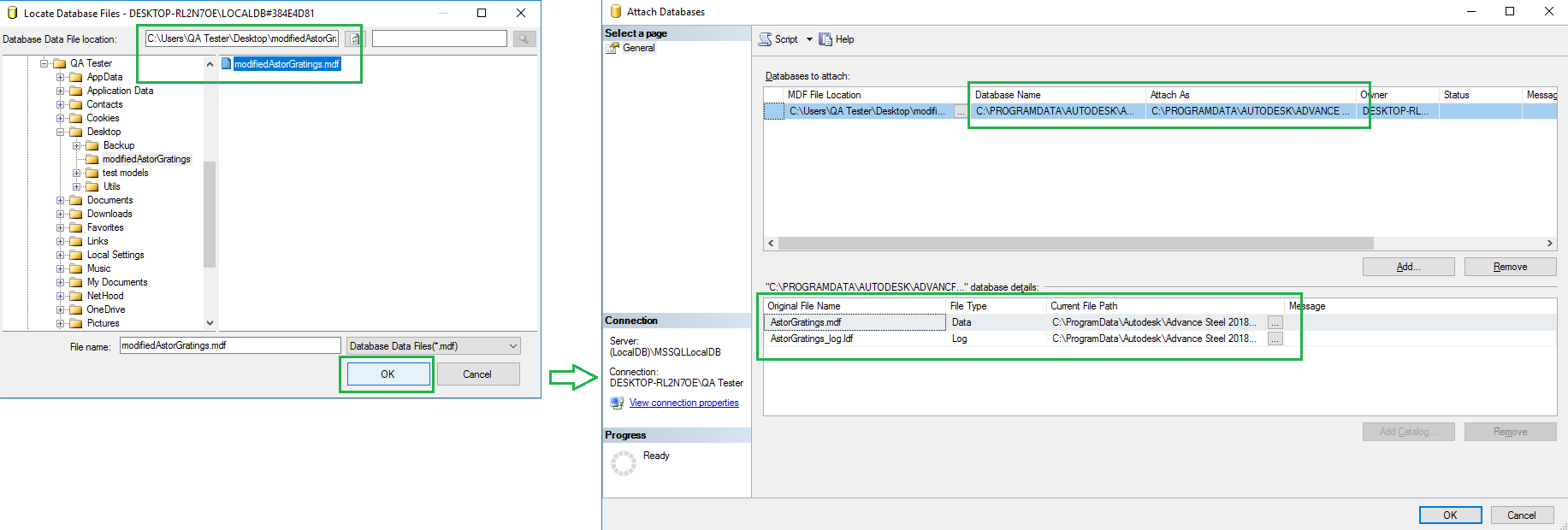

Attach copies of Advance Steel databases
If you make a copy of an Advance Steel database in a different location on the disk and rename it, when you need to attach the copied database it is important you make some adjustments to be sure that the database copy is targeted.
After adding the copied database using the Add command, notice that the original database is still referenced:
This means that if you continue with the attachment process and you make changes in the database afterwards, the changes will be applied to both the original database and the copied database.
In order to make sure that the changes are made only to the copied database and not to the source database too, you need to make the following settings in the Attach Databases window:
  • Edit the path referenced in Databases to attach field - enter the path to the copied database, instead of the path to the source database.
  • Edit the path referenced in the database details field (in the bottom side of the window) - enter the path to the copied database, instead of the path to the source database.
  • Remove the LDF reference in the database details field.
The attachment process can be validated and the copied database will be available for editing in SQL Server Management Studio:

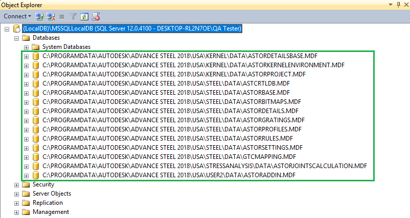

  • To make sure that the list of attached databases in the Object Explorer is up-to-date, right-click on the Databases category and select Refresh from the contextual menu.
  • If Advance Steel or Management Tools are started, all the Advance Steel databases are automatically connected and attached to the SQL instance and they will be automatically visible in the Object Explorer list:
