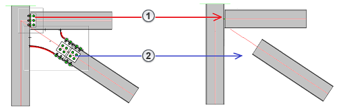

  • If all or part of the intended input elements are already used by other connections, then the propagation tool will not take them into account. To avoid this, it is recommended to propagate the connection in a specific order, such as the one illustrated bellow:
