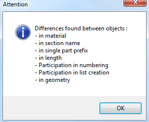

This tool compares two objects and lists the differences in a window. It is useful to display the differences between two objects with the same part mark.

Display the differences between two objects
- In the Output tab
Part marks panel, click
(Differences between tow objects).
- Select two objects.
- The differences are displayed in a window.
- Click OK.
