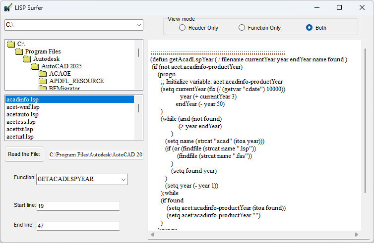

Displays the contents of an AutoLISP file by individual functions.
Enter LSPSURF to display the LISP Surfer dialog box:
Note: LSPSURF does not work correctly with code that uses in-line comments.
Dialog Box Options
Read the file | Reads in the selected AutoLISP file |
Function | Allows the function to be selected for display |
Start line | Displays the line number of the function's first line |
End line | Displays the line number of the function's last line |
Header Only | Only the function header is shown |
Function Only | Only the function code will be shown |
Both | Both the function header and the code will be shown |
