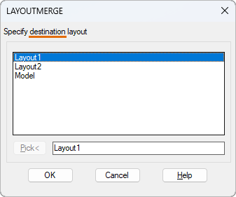

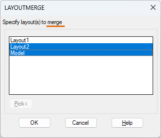

Specify the source layouts to be merged:
Specify the destination layout into which to merge them, or enter a name for a new layout:
