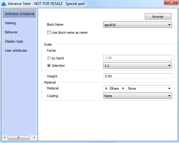

Special Part Dialog: Definition & Material Tab
On this tab of the properties dialog box you can define the weight, the material and the insertion scale factor for special parts.
Option Description
Browse button Displays a standard file selection dialog box where you can select the special part DWG file.
Block name Selects the name of the special part DWG file.
Use block name as name check box When checked, the block name appears on the Naming tab, in the Free remark field.
Scale
Factor
  • by hand: type the value.
  • Selections: select the scale from the drop-down list.
Weight
Material Material: type and subtype selection lists.
Coating: type selection drop-down list.
