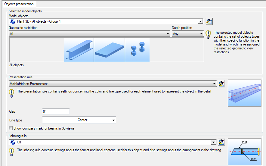

  4. Add two new object presentations, using the (Add a new object presentation) button in the Object presentation tab. The two new rules will be added to the end of the list and they will be a duplicate of the first rule - will be changed as part of this configuration.
  5. Configure the object presentation to match the requirements. Double-click on the line to go to the more advanced view of the configuration.

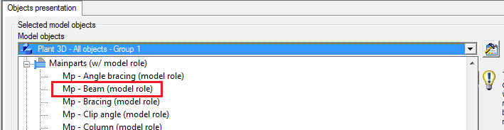

    1. Model object: This option will control what object from your model will be detailed by this specific line. Part of this configuration is to match specific model roles - those model objects need to be selected to match the object type (beam, plate, etc) and the model role. Search through the list and select the required model role. The out-of-the-box Advance Steel provides a wide series of pre-configured model objects. The model object for beams with the Beam model role exists and it is named Mp - Beam (model role).
      Note: Mp is short for Main part, so this model role will also act as a filter for main parts in assemblies.
      If a required pre-configured model object does not exist, it can be added. For example, the model object for the Railing Handrail Landing model role is not available, so it needs to be added as follows:
      • Use the (Set) button next to the Model object category to access the configuration page.
      • Create a new model object using the (New) button.
      • Configure the Model object and Model role fields as needed.
    2. Presentation rule: Set both the new object presentation rules on SingleLine.
    3. Set a labeling rule if needed.

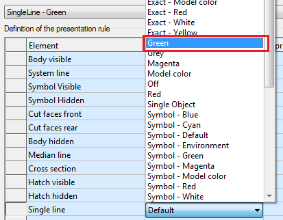

  9. Expand the Color column combo-box for the Single line element and select a different color (e.g. Green).
  10. Repeat the steps for the other model object (Mp - Beams (model role) and create another Single line presentation rule, with a different color.

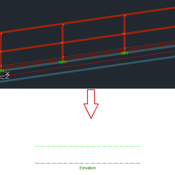

    Detailing this small sample model with this drawing style will result in a drawing with two lines: a green line for the Railing Handrail beam, and a blue line for the beam:

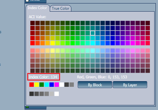

    3. Color - the value associated to the required color. The table supports color codes from 1 to 256. To easily find the number associated to each color:
      • In the Management Tools application, access Defaults.
      • Browse to any category that contains defaults which set a color (e.g. Drawing-Presentation / Colors).
      • Click on the property value of any default to see the color table. Hover the mouse over various colors and check their index color value:
