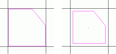

To shrink or enlarge polygon plates, you need to select one or more plates and enter a dimension. A negative value shrinks the plate, while a positive value enlarges the plate.

Shrink polygon plates
  1. On the Objects tab Plates panel, click (Shrink / expand poly plate).
  2. Select one or more plates to shrink and press <Enter>.
  3. On the command line, input a negative value to shrink the plates.
  4. Press <Enter>.
The plate edges move in a perpendicular direction by the entered dimension.
Enlarge polygon plates
  2. Select one or more plates to enlarge and press <Enter>.
  3. On the command line, input a positive value to enlarge the plates. Press <Enter>.
  • The plate edges move in a perpendicular direction by the entered dimension.
