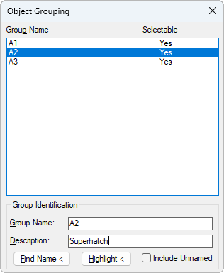

Modifying a Superhatch

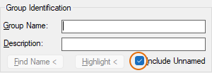

Superhatch objects are glued together using unnamed groups. Therefore, they are not associative. If you want to modify a single object that is part of a superhatch, you can use the GROUP command to turn off selection of the group as follows:
1) Start the group command.
Command: group
2) Make sure that the Include Unnamed check box is selected.
3) Select the group. Note that "superhatch" appears in the description field for groups created by SUPERHATCH.
4) Click Selectable.
5) Choose OK.
The individual objects can now be modified separately.
