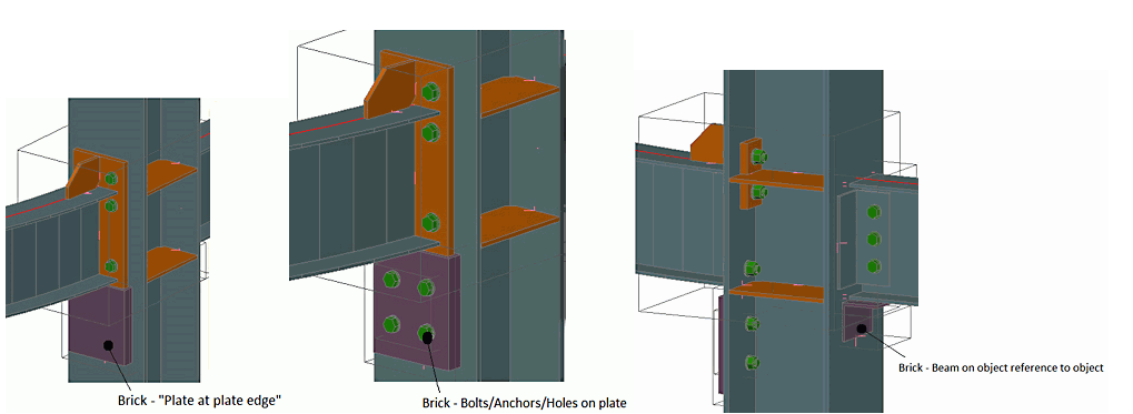

Building bricks are similar to connections. Each one creates only one or two basic elements controlled by construction rules.
Like connections, building bricks are created with all their parts and connection objects using a single operation. At the same time, a connection logic between the building brick and connected elements is established.
The building bricks are grouped on the Custom connections tool palette.
To add a brick, select the desired element from the Custom connections tool palette and select the elements to be connected. You can modify the properties of the created elements using the brick properties dialog box.
Examples of bricks:
