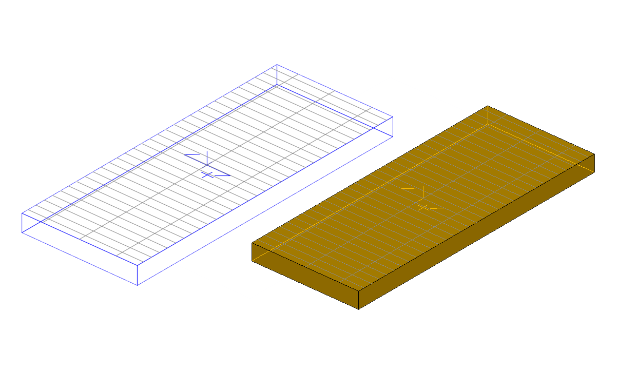

Change the grating display type
- Access the grating properties.
- Select the Display type tab.
- Select the desired representation type.

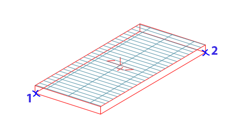

Create a rectangular variable grating
With this tool you can create a rectangular grating element by two diagonal points. The rectangular gratings are placed in the X/Y plane of the current coordinate system.
Access the command
On the Objects tab
Grating panel, click
(Variable Grating, rectangular).
Command line: _astorcreatevariablerectgrating
To create a rectangular variable grating
- Place a coordinate system with the X/Y plane in the required grating plane.
- On the Objects tab
- Specify the first corner point by selecting or entering coordinates.
- Specify the diagonal opposite corner point by selecting or entering coordinates.
- The grating is created and the properties dialog box appears.

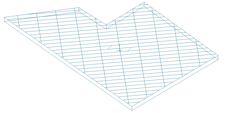

Create a polygonal grating by points
With this tool you can create a polygonal grating element by picking points. The polygonal gratings are placed in the X/Y plane of the current coordinate system.
Access the command
On the Objects tab
(Variable Grating, polygonal).
Command line: _astorcreatevariablepolygrating
- Select the corner points one after another and press <Enter> when finished.

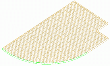

Create a polygonal grating at a polyline
Another way to create a polygonal grating is to transform an existing polyline, which does not have to be closed, into a grating.
In this case, the position of the grating element is independent of the coordinate system since it is determined by the position of the polyline.
Access the command
On the Objects tab
(Grating at Polyline).
Command line: _astorcreatevariablegratingfrompolyline
- Select the polylines and press <Enter>.
