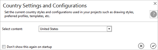

Select the country specific content for the English and French installations
For the English and French language installations, a content selection dialog appears at the first start-up of Advance Steel. In the Country Settings and Configurations dialog you can choose the country specific settings which share the same language: English ( United States, United Kingdom, Australia and English International) and French (France and Canada).
Don't show this again on startup check box If checked, the Country Settings and Configurations dialog will no longer appear when starting Advance Steel.
If you need to make the Country Settings and Configurations dialog appear when starting Advance Steel again:
  1. In the Home tab Settings panel or in the Tools tab Tools panel, click (Management Tools).
  2. In the Management Tools application window, choose the Options tab.
  3. In the Options tab, uncheck the box for Don't show the "Country Settings and Configurations" window when Advance Steel starts.
