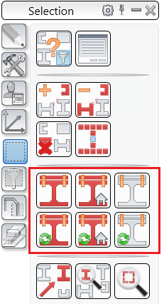

There are several functions that allow highlighting the connected objects, by marking them with red. These functions are grouped on the Selection tool palette and allow:
  • Displaying objects connected in the shop
  • Displaying objects connected on the building site
  • Displaying the connection elements.
Display connected object
Displays objects connected through bolts or welds. Select the function and, then, select a connection of the model and validate. All connected elements will be highlighted with red.
Remove marking + display connected objects
Deletes the previous marking and making a new marking of the objects connected with bolts or welds. Select the function, then select a model connection and validate. All connected elements will be highlighted with red.
Display objects connected in shop
Displays the object connected in the shop. Select the function and, then, a part of the model, and validate. All elements connected in the shop will be highlighted with red.
Remove marking + display objects connected in the shop
Deletes the previous marking and making a new marking of the object connected in the shop. Select the function and, then, a part of the model and validate. All elements connected in the shop will be highlighted with red.
Display connection means
This function allows displaying the elements that connect the parts between them (welds and bolts). Select the function and then a part of the model and validate. All the elements of the connections will be highlighted with red.
Remove marking + Display connection means
This function allows deleting the previous marking and displaying the elements that connect the parts between them (welds and bolts). Select the function and, then, select a part of the model and validate. All the elements of the connections will be highlighted with red.
