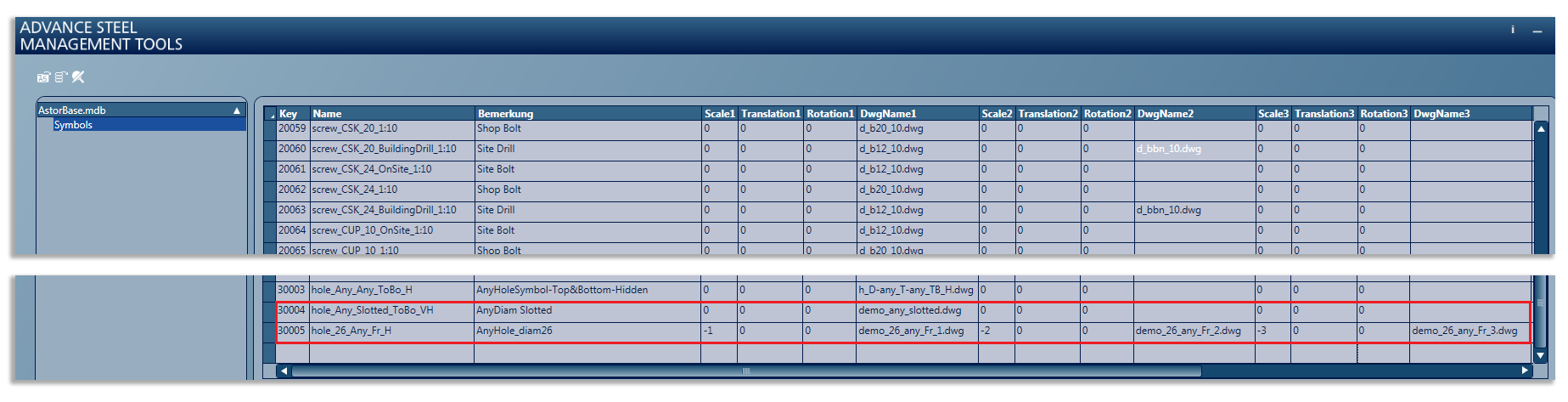

- The symbol is created from three parts (DWG files):
This is how the two example hole symbol configuration lines appear in the Symbols table:
