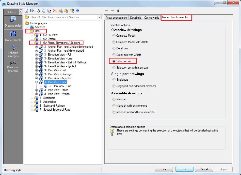

  1. Access the Drawing Style Manager from the Output tab > Document Manager panel.
  2. Go to User > GA - Plans, Elevations/Sections > Plan View ­- Line.

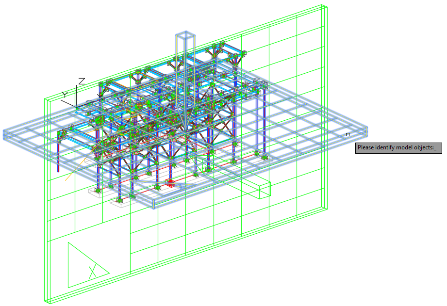

  3. In the Model objects selection tab, under Overview Drawings, choose Selection set and click Apply.
  4. Click Use in the Drawing Style Manager window.

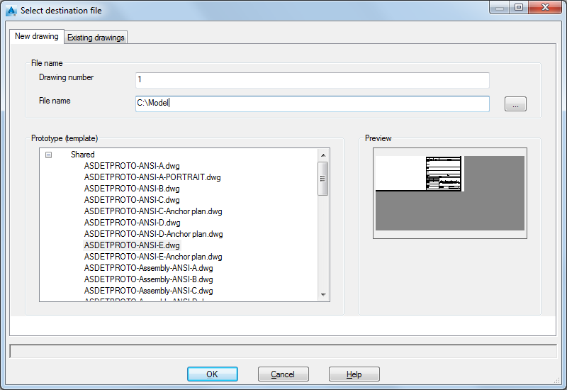

  6. Select the camera and click OK in the Select destination file dialog.

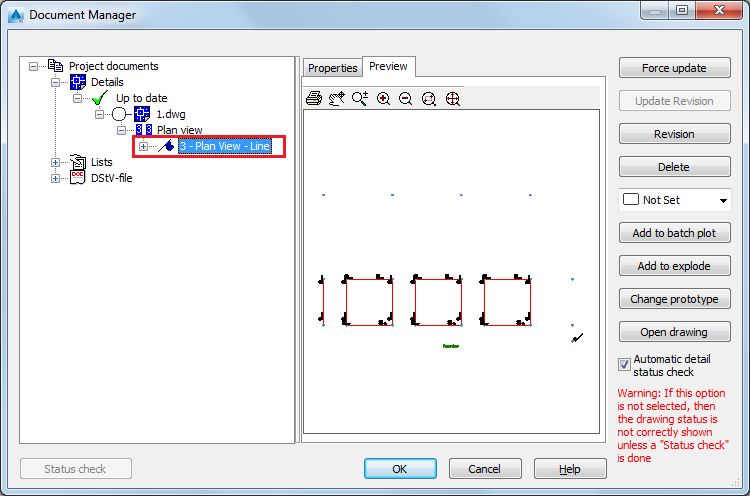

  7. Go to the (Document Manager), from the Output tab.
  8. Open the created detail drawing.

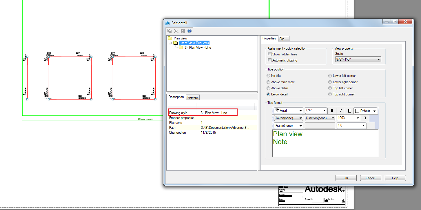

Notice that the drawing style used for creating the drawing is the one chosen in the Drawing Style Manager.
