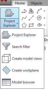

The Project Explorer displays the project components and provides quick access to management commands via context menus.
The Project Explorer button is located on the Home tab Project panel:
Command line: _AstM11CommCreateProjectExplorer
